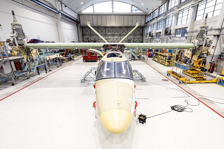

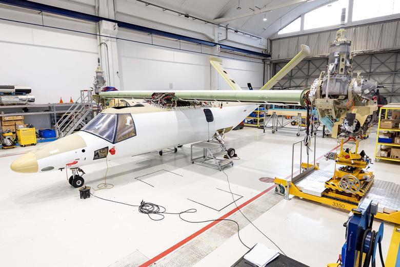

    The Next Generation Civil Tiltrotor (NGCTR) Demonstrator that Leonardo is working on is being prepared for its maiden sortie/first flight. This has been a long time in the making as it was originally expected to be flying since 2020. Leonardo suggests that the Covid-19 pandemic and its associated spin-off effects derailed that timeline. However, the first demonstrator hull is in final assembly and below you can see some of the most recent images of the progress thus far.
