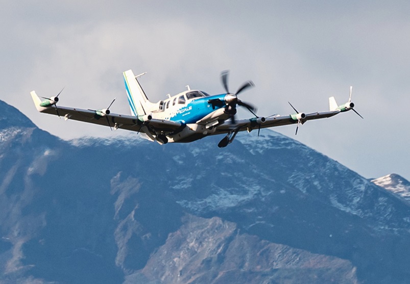

  3. In fact the testbed EcoPulse which has the regular turboprop nose-mounted engine and prop coupled by 6 turbo-generators on the wings has flown as many as 14 'electric' flights with those 50 kilowatt systems. All this since commencing those flights in November 2023. This program is running relatively smoothly with the next set of tests to be focused on noise generation. They will then open-up the full flight envelope for the aircraft and later fully test the hybrid-electric system.
