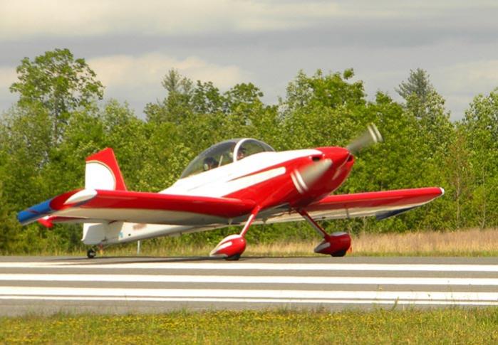

    Since that date, 14 patents were filed, of which 2 are in the USA. In April and June 2012, actual tests were made using an RV4 and RV8 with results far beyond the laboratory wind tunnel tests and numerical wind tunnel. 2 further tests are planned on an RV7 and RV8 in Europe in 2012.

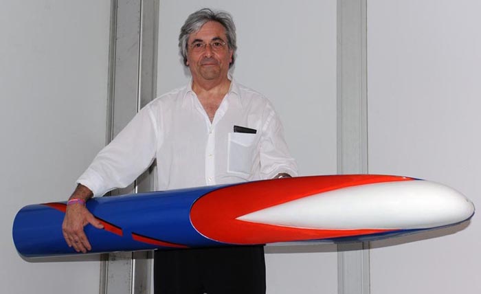

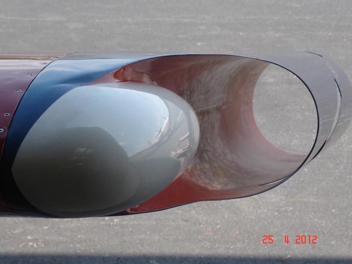

    Notice that the leading edge of wing tip of the airplane is continuous with the leading edge of the MINIX tear-drop shaped inlet of MINIX. This specific form causes a COANDA effect and allows:
    - Accelerating and directing the flow towards the inside of the cylinder
    - Directing from its creation, a part of rotary motion of the vortex.
    Indeed, when the relative wind enters the cylinder, half of the efficiency is achieved. The acceleration of the air entering by the inlet of the cylinder will cause a greater depression in and capture a portion of the pressure swirling around the cylinder by a helical slot along the entire second half of the device. This acceleration will cause the output to multiple mini-vortex trailing edge of the wing.
