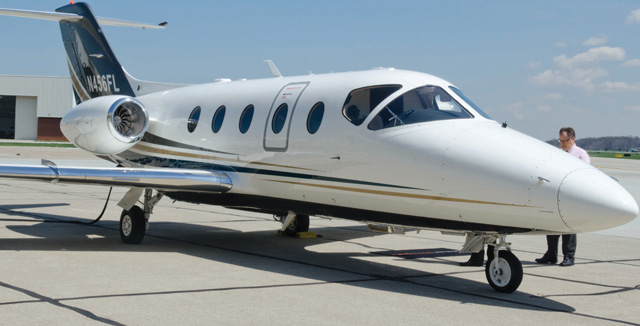

    A photo of the Nextant 400XT

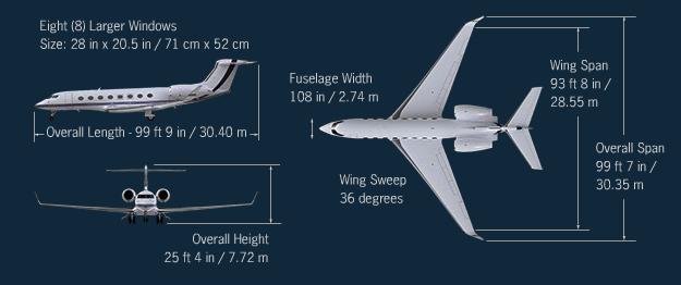

    The G650 is an impressive aircraft all-round, Gulfstream should be proud. I know this bird has a long wingspan but I didn't realize that it was practically 100-feet across! That's wider than a DC9-50 at 93'5''.
