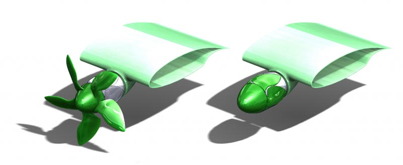

  2. NASA's newest revelation incorporates 18 small electric motors nestled into the leading edge of a super thin wing. The thrust created by all these props, spread out over the entire length of the wing, adds lift without the forward velocity normally needed for the wing to achieve lift. The advantage being thrust and lift are available for take-off, then several of the motors can be shut down once cruising speed is reached. Because the props fold back into their individual nacelles, the drag of the idle motors is negligible. At cruising speed, the narrow chord wing is sufficient to maintain altitude with minimum drag.

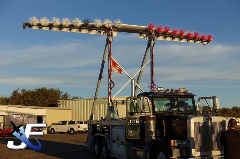

  5. The current test mule is a 31 foot wing with 18 electric motors mounted aboard the bed of a Peterbuilt truck for testing at Edwards Airforce Base, where it’ll be driven at various speeds to collect data on lift and drag coefficients. Once sufficient information is obtained, the plan is to mount the wing and engines to a Tecnam P2006T as a test bed to compare performance figures with traditional light aircraft.
